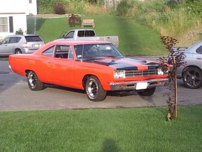

Yes the car is restored. It spent a year and a half in the body shop replacing new floors, quarters, roof, trunk floors, etc.... The rest of the work I did with my father and older brother. Had the car since 98. We got it as a track car that ran 11.2 in the quarter, she still had the original matching numbers drivetrain in it which was an amazing find considering she was a race car.

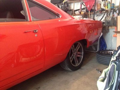

Here's some pics of her. Some are from local car shows and meets. I also took one with the charger wheel on it. In one pic you can see the charger behind her on our way into a show
