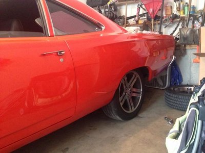

I'm not going with the 20s they would be to big and I wasn't planning on driving it with the 18s off the charger I just wanted to see what it would look like with an 18" wheel and see how much clearance I had

And as for the 18s off the charger they bolted up perfect in the back with no issues I wanted to try them up front to make sure I could turn the wheel without rubbing because the charger wheels are 18x8

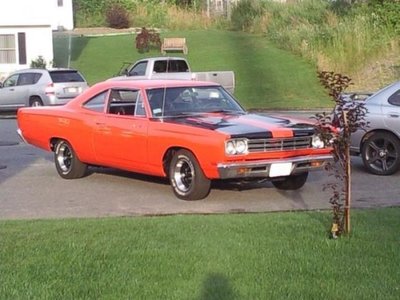

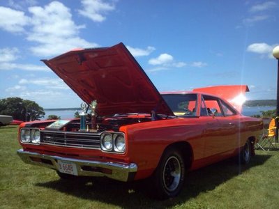

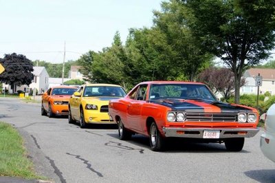

Yes the car is restored. It spent a year and a half in the body shop replacing new floors, quarters, roof, trunk floors, etc.... The rest of the work I did with my father and older brother. Had the car since 98. We got it as a track car that ran 11.2 in the quarter, she still had the original matching numbers drivetrain in it which was an amazing find considering she was a race car.
matts69
Apr 15, 2011
15
Here's some pics of her. Some are from local car shows and meets. I also took one with the charger wheel on it. In one pic you can see the charger behind her on our way into a show
