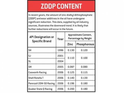

Zinc levels where reduced, not taken out of motor oils. This list is 10 yrs old. Not sure if they have come down further or not and I have not been able to find an updated list.
attachment.php
22,251
2,496
attachment.php
Any updated info since 2006? I know diesel oils like Rotella changed since then.
