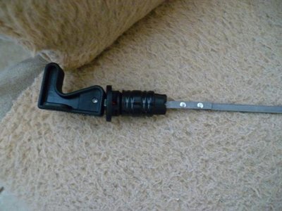

YES and NO, I purchased the steel dipstick tube that bolts to the bell housing and the dipstick has the FLIP LOCK handle at the top. I assume this is the STOCK steel neck and dipstick. I purchased the "TCI" tranny; 2400 stall T/C; fluid; dipstick and steel neck all as a package from Summit Racing.

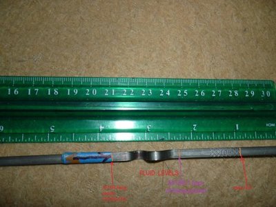

Attached is a picture of the trans. dipstick and the various FLUID levels. The overnight level; when it is HOT in driving condition; and what the level is after being parked for ONE hour after running it hot.
