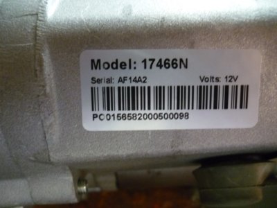

I purchased this starter from an INDEPENDENT PARTS store that usually sells items that NAPA carries. They could NOT tell me the brand but the serial number and part number on the starter matches the DURALAST GOLD starter advertised by AUTOZONE on the internet. What I did NOT like is that the one I purchased, $154 total including core charge, is ONLY $20 more than the AUTOZONE starter but mine is a RECONDITIONED one and AUTOZONE is NEW.
I was in a hurry to really compare the two in detail. I did look at them side by side and did take a few pictures. They did NOT look identical but did look like they would both work equally well.

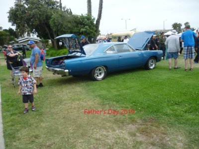

At today's car show, I substituted my RR with my Model A hotrod. It would have been pretty neat had I entered the RR because the car beside me was a 2018 DODGE and next to it, guys father, had a 1968 completely stock Roadrunner owned by the SAME owner all of these years...…………

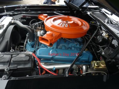

We also had the nicest 1972 Roadrunner I have ever seen to date. The owner just had it completely restored after a five year project. Beautiful BLACK paint and he upgraded the entire front end and the 400 CI motor as well.
It specially peaked my attention because my 1969 Roadrunner has a 1972 400 CI motor...……………….I'll try to upload a picture of this car later on.
He has TCI headers and also a high torque mini starter. He told me that TCI is the BEST header to use on a MOPAR. I have HOOKER full headers and mine look quite a bit like the ones he has.

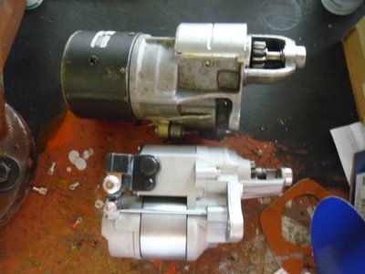

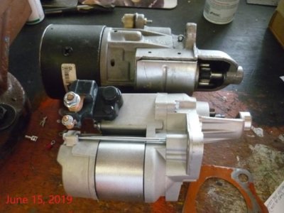

Pictures I took of the starters BEFORE I installed the mini high torque starter.

UPDATE: Just came back from the auto parts store. The owner told me the starter is a "DENSO" starter and that he has NO other options.
I took my stock starter to help point out the fact that the STOCK starter has the POSITIVE cable stud on the bottom where the mini starter is at the top which causes interference with the block.
Before returning it, I went to a very reputable generator/starter rebuilding shop across the street from the parts place. The owner told me he could relocate the positive cable stud but NOT towards the bottom and the new locations would also interfere with the block.
He also told me that this mini starter would do the job but that it is NOT a 400 CI MOPAR starter.
So, I got my money back and now starting to shop for a mini starter for a 400 CI motor. I have the HEAVY DUTY block with casting # 3614230-4 which came in the 1971-72 Chrysler product butted up to a "TCI" 1977 TF 727 "street fighter transmission".

The owner of the blue '68 RR is the ORIGINAL owner. He's attended 27 MOPAR shows at Wooley Park with it. My '69 RR was suppose to be there.

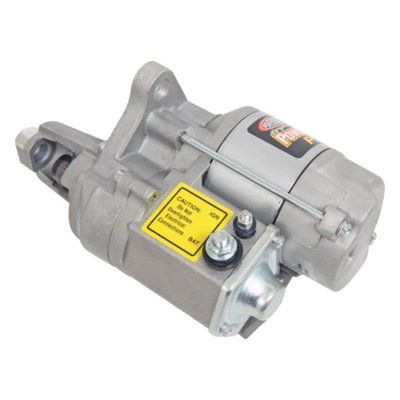

Once I got home I contacted 'SUMMIT RACING'. The guy I spoke to informed that ALL the mini starters have the cable stud on TOP. He recommended I use the PWM 9300. This PWM 9300 looks a LOT like the one I returned. The main difference is that the 9300 does NOT have all that black plastic around the cable stud. That black plastic is what was touching the block and preventing the starter upper hole from seating. He claims that this 9300 model was the fix for the problem I was having. He also informed me that if this starter did NOT do the job, the PWM 9463 will definitely work because the mounting is adjustable.
So, I ordered the 9300 and if that does NOT do it, at least now I know that my issue will be resolved...……...just have to spend a little more $$$$$.

I can NOT understand why the starter I returned had all this BLACK PLASTIC crap that interfered with the engine block to begin with.
Attached is the picture of the PWM 9300 that is suppose to work.

If you remove the plastic part there are two posts just like the PWM9300 has and they just clear the block.
If you take a close look at the BLACK PLASTIC, the right section TOP comes off but the bottom portion remains (snaps off- had it off and have NO idea why it is there to begin with). There is also a flat copper strap coming off the black plastic.
YES, the 9300 does away with the black plastic but I do NOT think that one can just remove the black plastic on the one I returned. If it was that easy, the parts store owner and his assistant plus the owner of the generator/starter shop and including me, all overlooked it. Hence, they came out with the 9300 model and I still DO NOT know for sure that even this one will work. Will find out shortly when it gets here.
