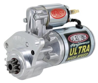

the powermaster is the one I have
Hi 'quick bird', I have one of those on top of my radiator on my Model A hot-rod. The dove is suppose to indicate how QUICK the Model A was for its time...…LOL

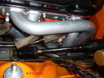

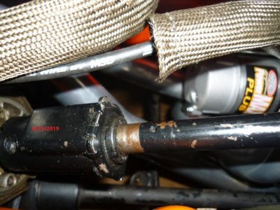

PROBLEM SOLVED:
Not bad, ONLY had to take off the hooker header and do everything TWICE...…...usually, for me, it is at least three times and sometimes four. If I had to do this for a living I would starve to death...………….LOL
I went with the PWM 9300. It has all that 'black plastic' garbage removed. I can tell you, I ONLY have approx. 1/6" between the starter battery post and the block. That inspection digital camera I purchased a while back is great.
I purchased from "Summit Racing". The salesperson was very helpful and the starter did not take long to get. I highly recommend them.
As someone suggested, make sure you install and tighten the cable BEFORE you tighten the starter to the bellhousing. I was able to retighten the nut since it loosened up on me but it is a very difficult task to do with these headers.
I also noticed that I did NOT see any GROUND cables coming from the engine to the frame. I rather err on the side of too many ground cables. A good ground is also recommended with this starter because it pulls a lot more amps than stock. I installed a good ground as well.
A couple of pictures attached.
