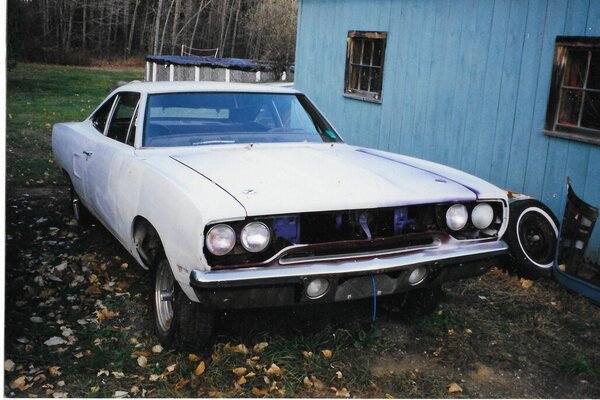

So after owning a `70 383, 4spd car back in 1980 and having to get rid of it instead of my dream of restoring I laways wanted another one. I`ve had other projects come and go along with my Barracuda I bought in 1982 which is my "keeper" but after selling a `69 Barracuda I built I decided to try and find another `70 road runner, this was in the year 2000. This time I wanted a factory FC7 painted one, I would have preferred white interior, 4 spd and other options (440-6, Hemi) but as always my budget was limited. I was able to find one for sale in New Jersey for $5,000 that looked very solid for a North East vehicle, had matching numbers 383 engine, missing transmission and a lot the interior which was black bench seat, column shift. Not having a truck or decent trailer to go get it I had a buddy offer to pick it up for a reasonable fee and since I was buying it sight unseen he could also check it out when he got there. I was very happy when I looked at t once it was home as the seller described it accurately, I`ve been buying parts for since then and had the engine rebuilt but otherwise have not done much with it. I finally made room in the shop by selling my truck project so have the space and some cash to finally get the project going. The plan is to go mostly stock looking with some added options and some "Day Two" add ons like slot wheels, Sun tach etc.
