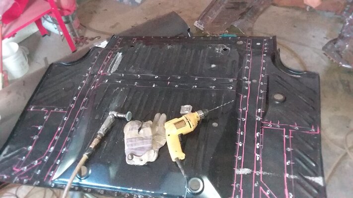

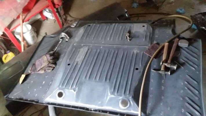

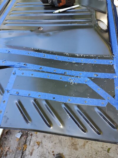

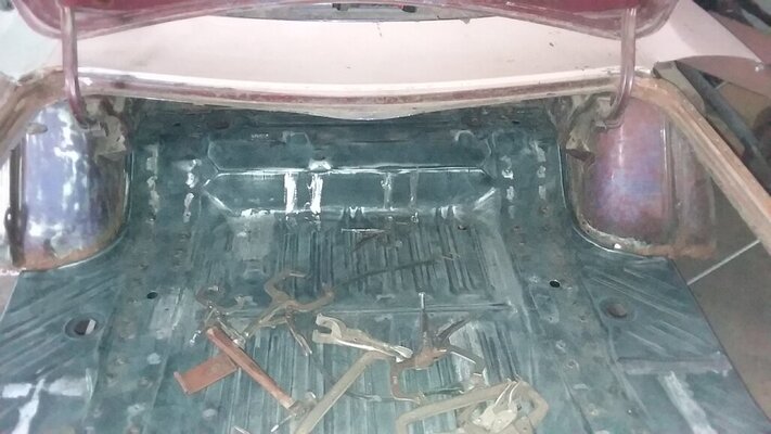

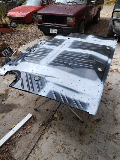

Drill baby drill! Got the holes done on the trunk pan and the bonus is I remembered to sand and scuff it BEFORE I welded it in - which is much easier.
7,846
3,425
I read to remove the shipping epoxy on the sheet metal from AMD. I wondered why. So, I cleaned it off and found rust in some places. The parts must sit for a while before going to the paint booth. After that I cleaned all my panels prepped with rust proofer then epoxied them. That is a fact of drilling all those holes. Too bad we don't have the welding gun the factory had where the frame was grounded, and you just pushed the tip of the welder to it. Would make things so much faster. Doing a good job and wish it all goes well. :thumbsup2:
The e-coat is usually a good base for primer but after your discovery I`m not so sure, I may have to sand a few sections to bare metal to see. I still need to prep and coat inside the rails with rust preventative paint before welding the pan in. Ya, it would be great to a spot welder like the factory did, there are some portable ones available but for the few cars I build not really worth the investment.
7,846
3,425
Just to say did not paint my trunk the color of the car. Was looking for durability. So had bought a bed line spray gun with 180 tip hose and 360 fan. to do inside every crack and craves. Of frame rails and rocker panels. Used Rust O lumen bed liner on the trunk after epoxy painting first. Had too thin it down some so the gun would spray it. Now it is not that rough the sand settled to the bottom of the gun. Yes, a little bit came out but not that bad. So far with the bottom of the car done and in wheel wells it is holding up just fine. This was the final sealer in and out of the car where I know it takes a beating. Also sprayed it inside my doors helps with noise. I guess I went a little crazy with it but everyone say's it will make the car last longer. LOL. Doing a good job guy's and hope you can get those runners on the road soon. :thumbsup2:

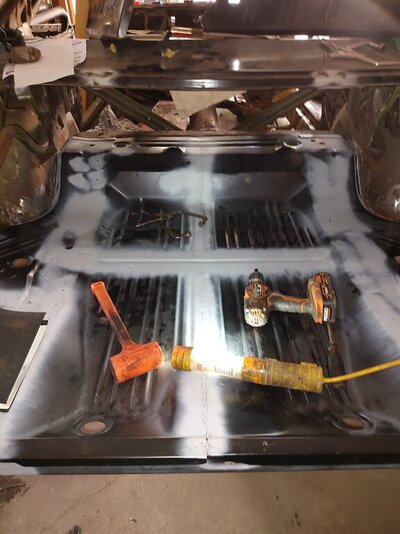

Not much progress on the car between holidays and my wife, myself and kid getting the China virus right after Christmas, hoping to start welding the trunk floor in next week. Another distraction was kid's cub scout Pinewood derby tomorrow, as a fundraiser they are having a separate parent's race so we had to build two cars this year. Kid's car is zombie apocalypse vehicle, hopefully you can tell what mine is.

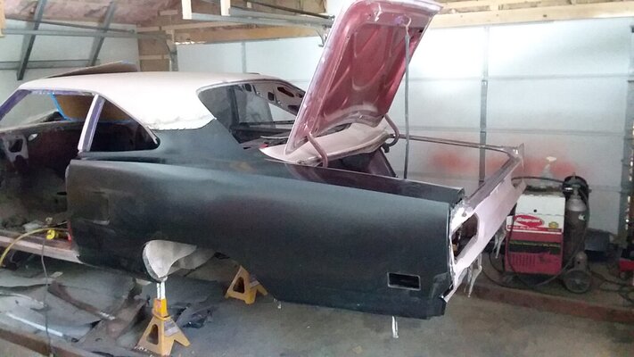

Welding has finally begun! Overall pretty happy with the fit, few areas need some minor tweaks. Once I finish plug welding I'll finish trimming off the quarters and fit the new ones up along with the trunk extensions.

A little more progress - trunk floor is 90% welded and ground so started fitting extensions and quarters. They will need some tweaking in a few areas but not to bad overall.
