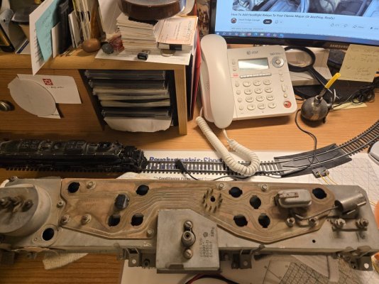

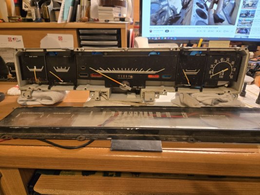

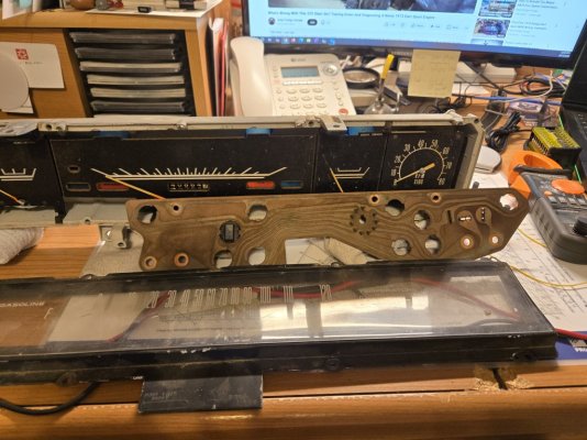

So what can I bring inside to work on? The gauge cluster!
It's got the Voltag Limiter and the Condenser and one lamp. All the pins appear to be there which is nice!
The front plastic cover is off but has a few scratches that needs attention. I cleaned and waxed the clear plastic which made a noticeable difference. However, I'd really like to polish those deeper scratches away.
I might get a new board with a solid state voltage limiter. Hopefully I can locate the cannon plug that hooks up to the pins. Right now, it's difficult getting continuity very far from the pins.
1000013086.jpg I tested the Ameter, Fuel Guage, and Coolant Gauge for a simple operation check with a 9 Volt Battery. All 3 Gauges responded with the test voltage. Now I need to build a low-voltage electrical system based on resistance to see if the Gauges read accurately.
