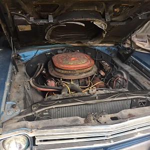

You are awesome!!!!! Thank you so much!!! I have one more question for you if you could help with this... my block number is
248813012 LL D N I. with
5-18-67 on the top right of tab, is this the correct block for this car or what is it?

Are you sure about the 2488130? Could it be 2468130? The 88 part of the number is not a casting number that I can find anywhere. I have my doubts this is a matching number engine. The casting number won't tell you this though, the serial number should be stamped on the block.

Experts would know this question, I'm not an expert. The 5-18-67 casting date would make more sense this was originally in a 1968 car. But this casting code 2468130 was on 383's up to 71, so I don't know. From what I can see of the engine it is the correct color for a 1969. Can you see any blue paint on the engine anywhere?
