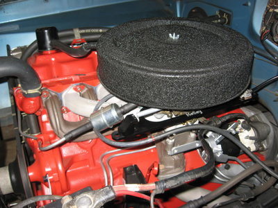

hi, go with a 4bbl. don't waste time or money on a 2bbl. the people selling the 2bbl stuff think its gold plated. it makes it fun to beat up on the 383 guys. its a little harder with the 440 guys, but not much. this is a holley 600 i took off a 440. i thought it would be too big and too rich ,but it was on my shelf. i started with #60 jets in pri and secondary with tall yellow vac spring. it runs very good. first pic shows unsilenced air cleaner assy installed. a hot slant has a sound of its own. use what you have. ron
