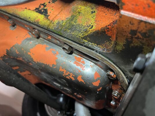

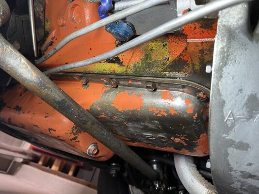

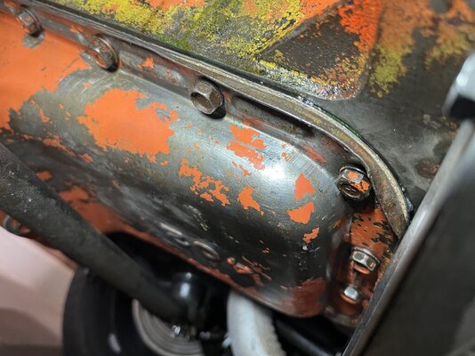

Well the leak has returned after 50 miles. Can’t say it is the rear main,but when I inspect the pan bolts around the rear of the pan near the inspection cover they seemed quite loose and there was not any signs of rtv pushed outward in any of the gasket layers.
Pics might tell one of the experts the next course of action if any.
Thanks in advance!

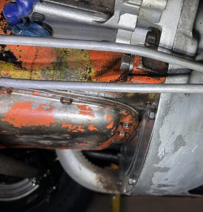

Kind of a mixed report,had trans leaks at the band adjustment bolts and while fixing those discovered that it’s the pan gasket area over the rear main cap. I don’t think there may have been any rtv run in that area,but I’m going back in one last time making sure the shop does it right and No over torquing the pan bolts. Should just suck it up and put on jacks and do it myself. The shop warrented their work so I will hang with them while they do the job and learn.

I don't see oil. I do see what looks like antifreeze. Could be a head gasket or a freeze plug. Hard to tell by a picture.

The shop did mention a questionable freeze plug. Don’t have antifreeze in the oil. The wetness in the pan gasket indicates to me that the gasket layering with the rtv was not done right. I know these old motors are going to eventually develop leaks but not after the leaks addressed have 50 miles on them. Another good reason to suck it up and jack stands and other safety things and crawl under it and then I’m sure it’s done right! I would like to have it all exceed my expectations,but let’s be real!
I’ll get there! Thanks

That green is old paint,I have rubbed on it and it is not wet nor does it rub off.
