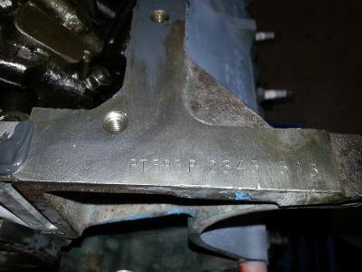

Looks like this
decodes like this PT = Trenton NJ plant, P =premium fuel, 2345 = born(cast) on date Friday, December 29, 1967 which would be right for a 68 383 most blocks were cast then put on a shelve to be built at a later date. If you can or ever take your oil pan off you can see this sequence #
