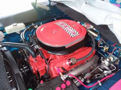

440 is in and runs great Have not put any miles on her yet waiting for my sons to help with hood., engine builder said ok to run for 500 miles with break-in oil and than change. I like to do sooner, Any Thoughts !!!!
quikbird
3,233
1,028
Sarasota, florida
engine looks good in there!
what type of lifters in there? did the builder use any of the molybnenum (spelling?) breakin lube ? that stuff will clog up the filter so not a bad idea to change that out sooner.

So Far 350 miles, will change oil and filter at 500, will be using 5 QT'S Valvoline 20/50 high Zinc . been Very careful up and down with RPMs and so far 65 mph( no long time / high way). at the most. Engine runs at just a little below the 1/2 way mark (85 degree day) on temp gage, using a 180 thermostat .
My plan will be to have broke in enough to drive to Carlisle in July for the 50th anniversary of the Roadrunner That's a 6 1/2 Hour drive for it from Mass..
