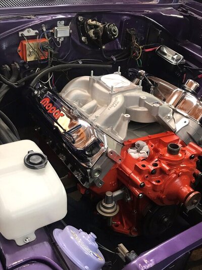

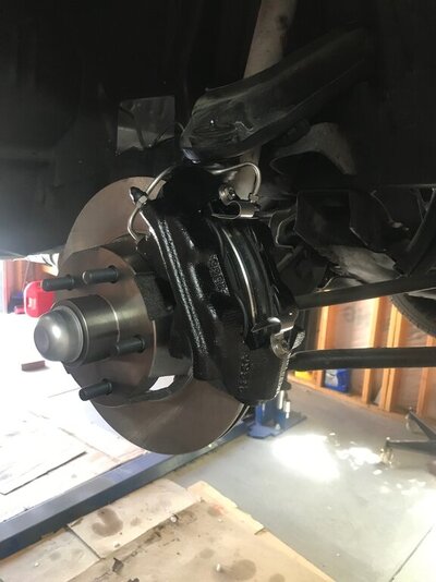

Well, the engines in, the front disc brakes are done, and the power steering is back. Got to bolt on everything else, and it's ready to run. Can't wait.

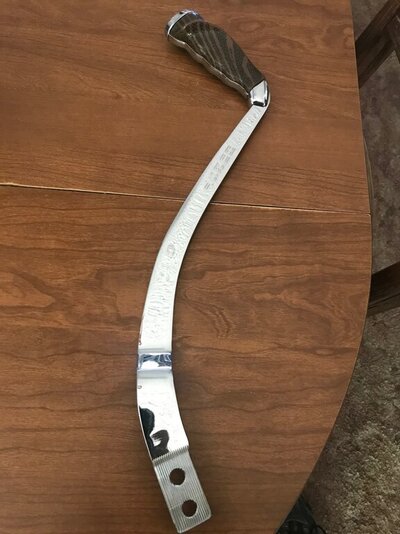

I agree. I did everything myself but the machine work. Hoping for a good start up with no hiccoughs or leaks. Still got a bit to do but I'm closer every day. Install the 4 speed next.

Sound grate Terry. You will get the leaks stopped. The new brake lines where a bare to get stopped leaking. But after a while tighten and loosen then tighten again. Stainless steel lines.

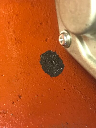

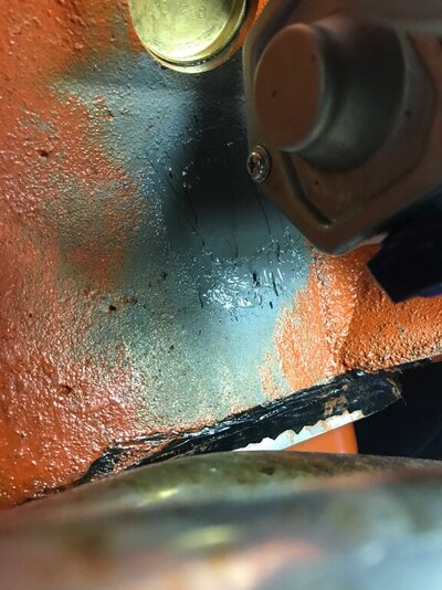

I finally found it. It's a pinhole leak in the block about 4 inches up from the pan behind the starter. Maybe from the casting process at the factory. JB Weld to the rescue.

OK, all patched up. We will find out in 24 hours. Just a bit of blow by in the block, so the JB Weld should hold.
