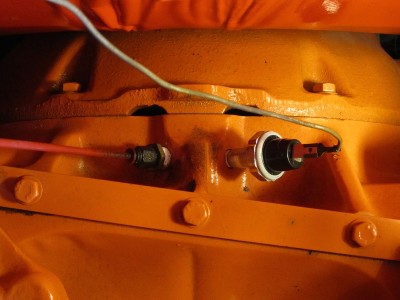

you do NOT need to use a T....look on the rear of the engine where the oil sender is.......on the opposite side you will see a pipe plug....take that out and run the line to your manual oil gauge, and you can run both, I've done that will all my big blocks.

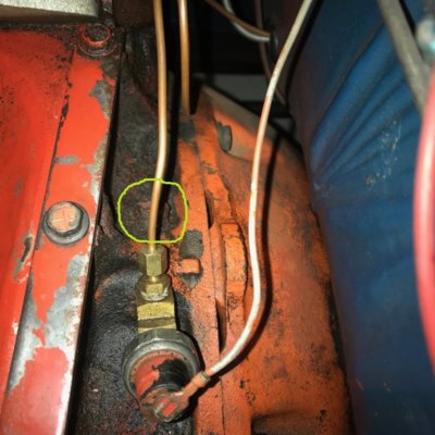

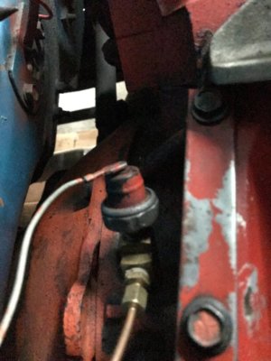

I don't seem to have the extra plug that Steve mentions. Here's how I set mine up for both mechanical and the factory warning lite.
EDIT:
Steve & Basketcase are correct. There IS another plug as pictured by Steve. The little bastard is tucked up so tight to the block (and camouflaged with grease that I missed when power washing it) I never saw it.
You can get the T fitting at any hardware store if you decide to go that route, but at this point it seems unnecessary.

Yeah I finally saw that Basketcase. See my EDIT in post #28. I almost want to redo it, but don't really see a good reason to.
