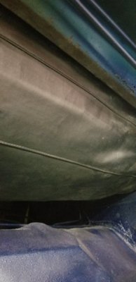

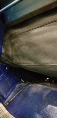

I'll try and get a picture. I have to leave town possibly tomorrow so it may be a week before I get to it. I store the car off site

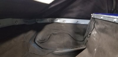

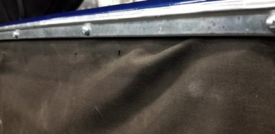

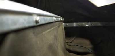

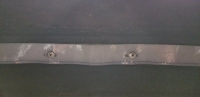

Thanks, a picture would help greatly. Please try to show the fabric below the boot if possible, I believe I am missing the piece that connects it to the seat.
Good luck! Could be easy enough to make or find something.
