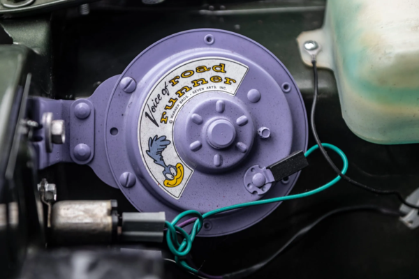

Anyone want to guess if that's the correct horn?

The '68 horn was plain color i believe starting in '69 the horn was purple so this one is correct. Are the hood pins factory??

I know what a Spartan is.
But Sparton is a portmanteau of Sparks and Withington , which is just funny.
It's supposed to have a date code.
But the way things work, I would not bet against that being missing from an ordinal Spurtin horn.
Wonder who put that on the horns anyway.
Some guy at Chrysler with a stamp?

Stamped at the vendors plant. Also not to nitpick LOL, but the bolt holding the horn is wrong. Should be 5/16-18 hex head sems bolt with paint cutter teeth under the parameter of the washer in a phosphate (brownish green) finish grade 5. Washer looks to be on the small side also.

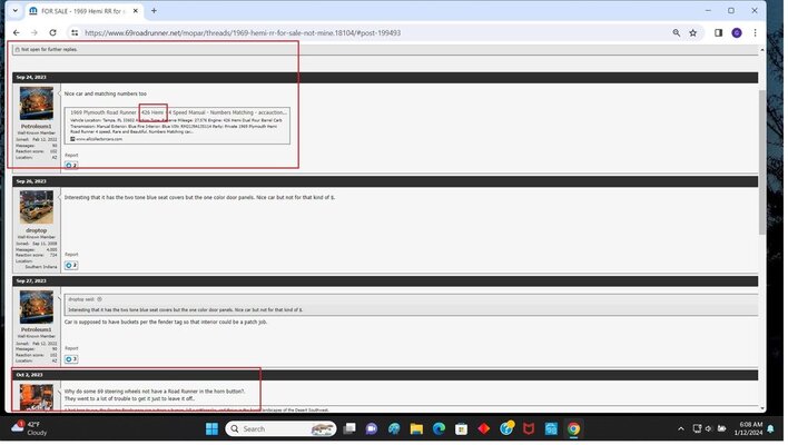

is that steering wheel center correct for a hemi let alone that ?
base 383 cars had the road runner center due to the horn sound / image / name use
