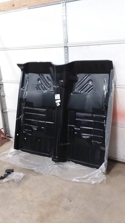

Last big piece of sheet metal arrived, I'll start cutting out the old floor once I have the quarters welded on.

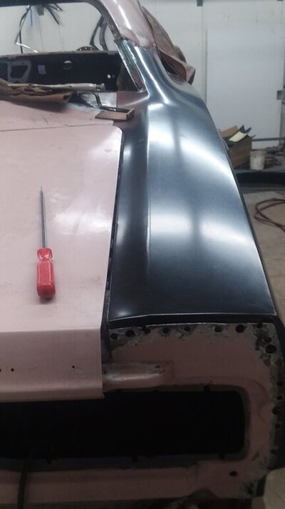

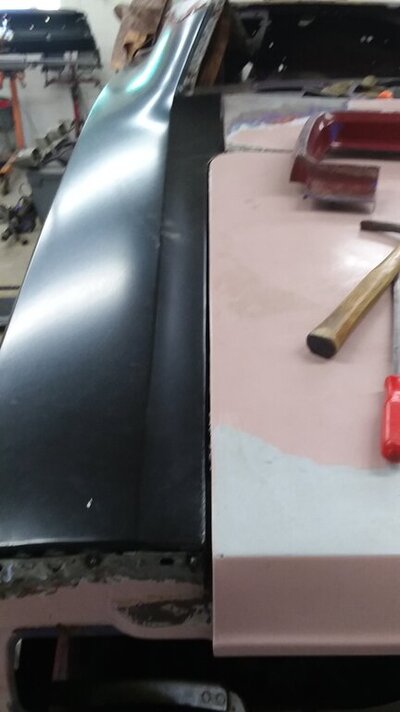

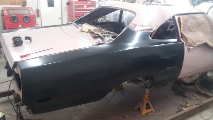

Quarter panel welding has begun! I'm still not 100% happy with the fit but I decided to just start welding and fit as I go. Trunk and door gaps are good, C-pillar is decent, problem areas are lower window channel and fit of end cap but I'll get them worked in. Once the drivers side is tacked all around I have one more fitting of the passenger and a little prep and I'll get that side tacked in.

Factory doors and roof skin are still on it so it`s definitely the quarters that are off, the main issues seem to be a little extra length and the C-pillar/rear window channel. I am not super happy with the fit but at least we have these parts available, when I did my Barracuda I could only get two piece trunk floor and quarter skins.

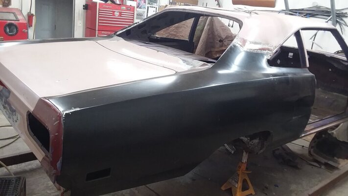

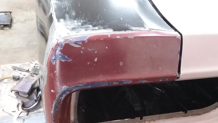

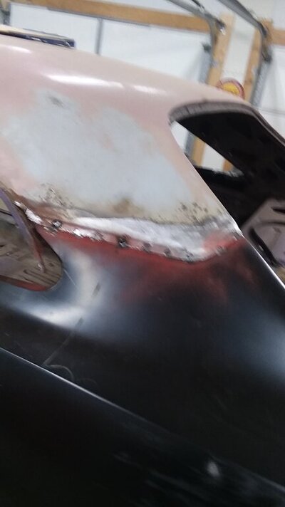

Trying to fit the end cap but ended up having to pie cut along the top edge as there seemed to be too much material there, I wasn't thrilled about cutting it but it was the only way to make it right. I am happy with the lines and once it's all welded and metal finished it will be better than factory. Now on to the next area.

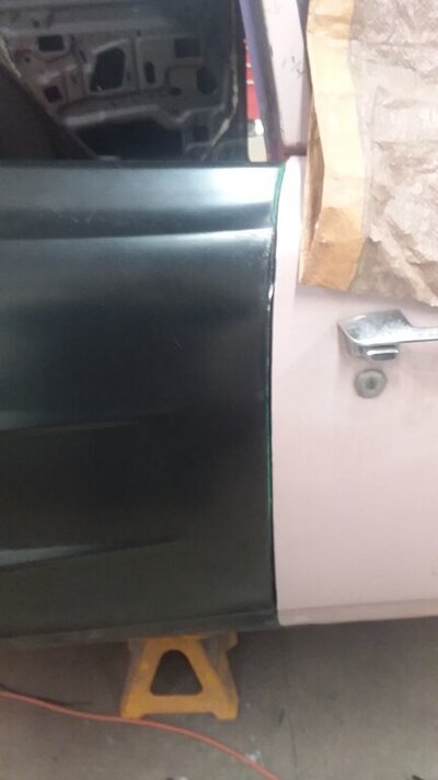

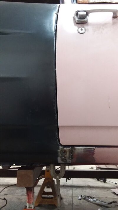

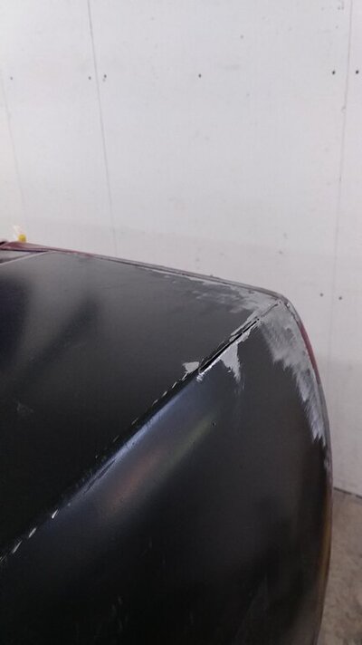

A little more done getting lines, you can see my expensive panel gap gage (a chunk of metal), shooting for 3/16". Door gap is done but I I have a little more work to do at the trunk lid/quarter/dutchman panel intersection.

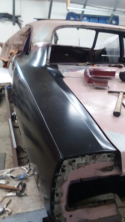

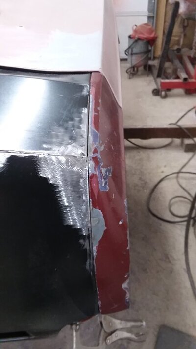

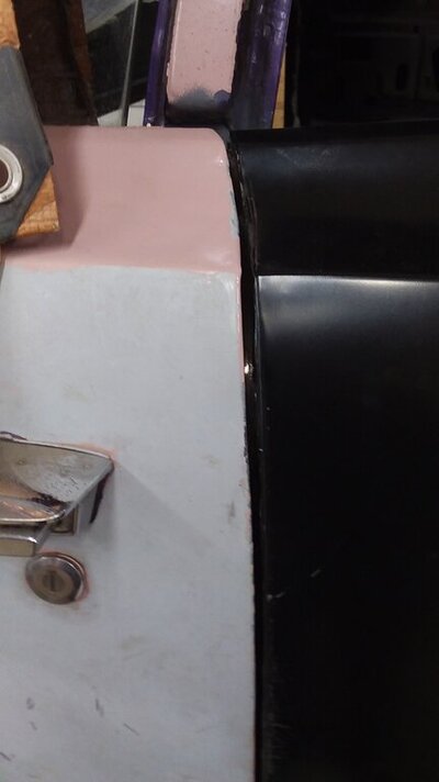

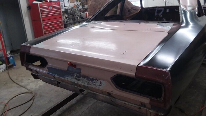

Passenger quarter is close enough to start welding. The trunk gap is really good but the door gap and rear window/sail panel area need some "finessing". Clamp, hammer, weld, repeat.
torredcuda
Oct 23, 2022
428
495
New Hampshire

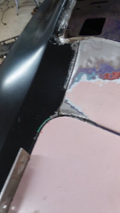

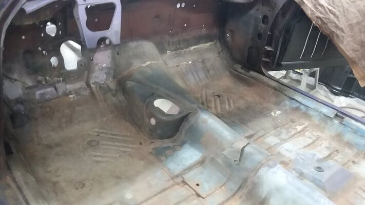

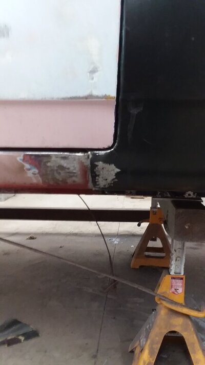

Not much progress that shows in pics but I have been working on it. Clamps are hung back on the wall and I'm finally done with welding on quarters! After I get some epoxy on them I am going to start fixing the mess some previous owner made of the floor pan.

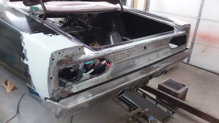

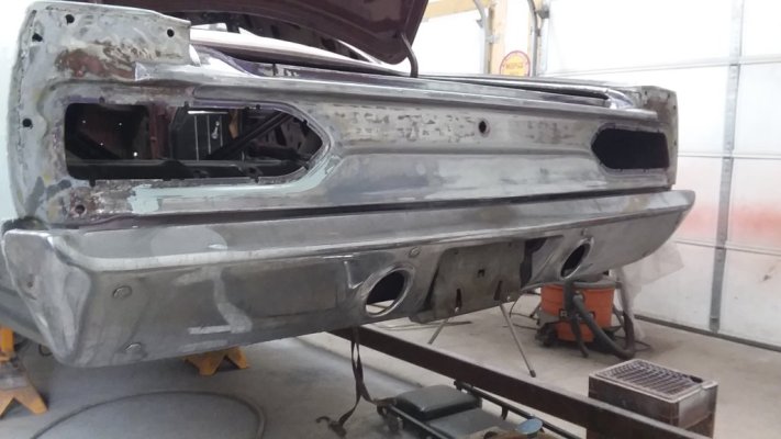

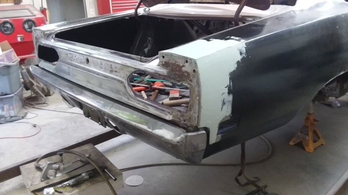

Finally found a decent rear bumper as mine was pretty bent up. I bolted it up so I could check the tail panel and lower quarter lines and I am pretty happy with them so mud work can continue and eventually primer some day.

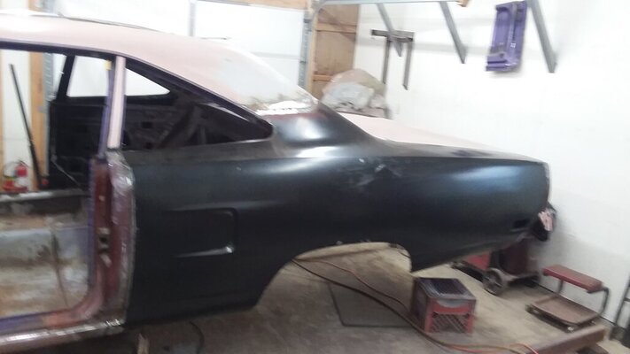

Been slacking with updates but I have been getting some work done between home projects, camping, Chryslers at Carlisle etc. Quarters are almost done, hopefully fully primed soon.
