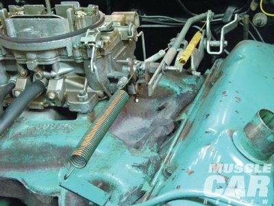

This is an older pic of a 440 set-up...I only see one spring.
4,004
736
Throttle return spring (single) is usually green and the kick down linkage spring is smaller in diameter and usually either yellow, orange, or red.
