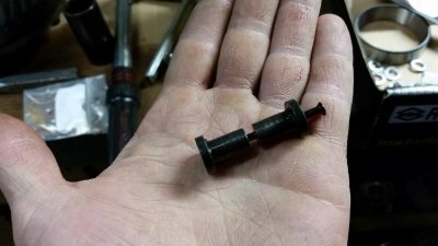

If the block is the size of the axle you are missing the spacer. You are working with a sure grip right? As you can see the spacers are smaller than the axle195386-434857ec6d48264131926dc2dae74e8e.jpg

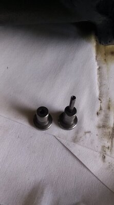

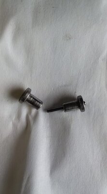

Yes found this little Buggers in bottom of housing, Does it matter how they go back in !!!
Thank You For all the Great Help TOMRR106411591_3053786414687112_3479123082481312424_o (1).jpg 106550089_3053785784687175_5508468029459465671_o.jpg 106550089_3053785784687175_5508468029459465671_o.jpg
