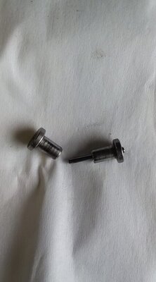

I know I do not put theses back in, other then putting green bearings on axle is there106411591_3053786414687112_3479123082481312424_o (1).jpg anything else I need to know?

Well I just wanted to make this a easier if down the road if for some reason I need to pull axles again. If every time those Thrust Pins fall out. I just talk to a Guy that does Diff work I had him 15 years ago set up another 489 case and is know for his excellent work . in the next town over and he said if you are getting the next generation green bearing it is ok to leave Thrust Block in just do not put Trust Pins back in

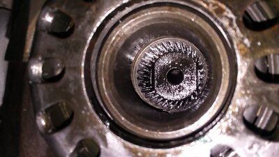

I left the button in my 741 8 3/4 when putting the green bearing's in. It was suggested to have it in their. But every thing bolted up good. Putting that retainer sleeve on is a bitch. Had a piece of pipe on the axle and pressed the sleeve on and lacked about a quarter of an inch so hit the press on top with a sledge hammer to move it on down. Should have heated it up like my tractor axle and slap it down with the pipe. That works better. Good luck Tom RR. Hope you get her done soon so you can get back on the road.

Leave the cross shafts installed. Just got this email from Cass at Dr. Diff. and leave the Thrust pins out 20200112_223000.jpg 106411591_3053786414687112_3479123082481312424_o (1).jpg
