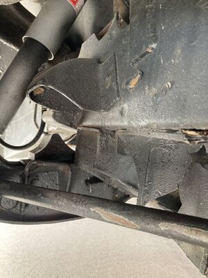

A little low and to the left?
7,696
3,231
You have your lower shock mounts swapped side to side and they are off 90 degrees. Shock mounting bolt goes to the REAR.
That is what happens when your in a hurry. Found that out when tried to install the shock's. Thanks they are corrected now for sure. Appreciate the head's up ACME A12.

You made me run out to the garage and peek underneath at the rear shock mounts and they both face rearward.
7,696
3,231
Ha Ha made you look!!!!. Oh what we do when we have done so much. Some thing so simple but not when your in a hurry. It is like what an older guy told me along time ago if you don't do any thing you will never do any thing wrong. Less we learn from our mistakes. :beep:

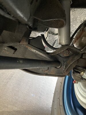

MoparJack, Took your advise and got under it on the left side where the rear end sags and adjusted the left side torsion bar bolt up and checked the front fender to ground measurement on both sides and funny thing is they are both pretty spot on. The distance between the left & right side bump stops is equal as well. Funny I have made no changes to the right adjuster.
I go back and take a look at the ass of the car and the left cheek looks like the right....nice!!
Thanks!!!

Had a brain fart...sorry here’s a pic of the lower arm bumpers,real close. So I feel good about that.
