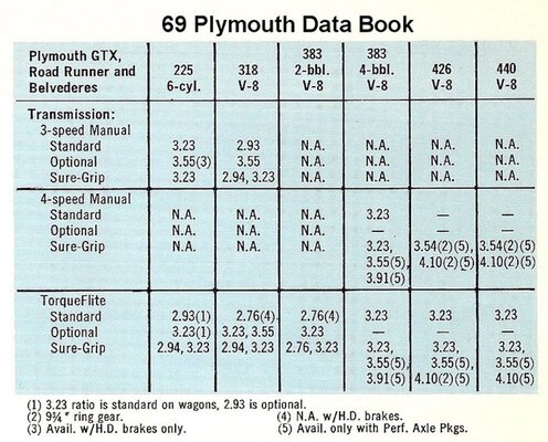

MoparDan
Mar 15, 2021
627
693
Stuarts Draft Virginia.
Another thing no one has mentioned is rear end ratio. Most automatics had a 323. That may be a little tall for a manual. I'm going to a 373 on my 512 stroker.
