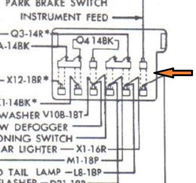

Also check the instrument feed fuse in the fuse box. (see diagram)
Hope this helps
