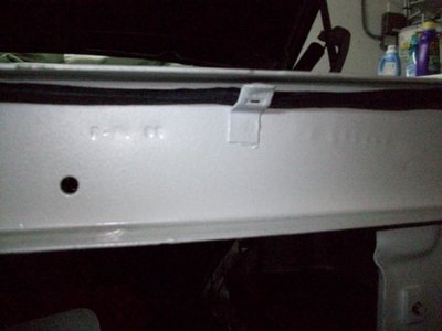

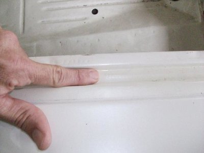

These two images show the location of the vin stamping on the radiator support and trunk gasket lip.
The first photo shows a date on the left and then the vin on the right. both are stamp on the drivers side of the support.
The trunk will have to stamps one under the seal and one in the valley.
The 68 will NOT have VIN numbers stamped on the body like the 69 and later cars.
It will have another number that will match the fender tag and broadcast sheet order number.
