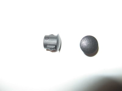

i was missing that piece also and i think i made something work. best as i can describe it is a plastic push in wire protector. found the right diameter and is had 3 or 4 locking tabs and i slit it length wise and slid it on the brake release rod and into the hole. i'll try to find a pic for reference.
mac
What ?
1,396
120
lancaster, new york
here is the pic of the piece i used. it is described as a nylon hole plug. i drilled a hole for the brake release rod and slit it length wise to slide over the rod and then into the hole on the bracket.
