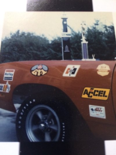

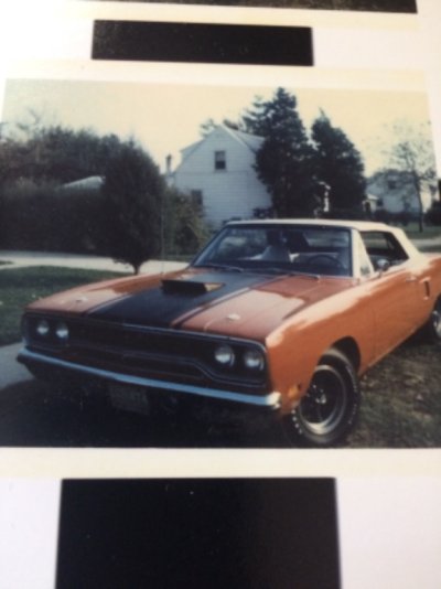

For reference, this was my dads ride height when he went racing. His bud secret to weight transfer was to crank the torsion bars all the way up for maximum weight distribution. Say what you will, but he was running 12:30 @108 right off the showroom floor. First pic, daily driver ride height, 2nd pic, ready for racing.
