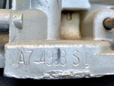

    what about a A7-4968 s or could be 4988 hard to read
  12. 69hemibeep
    Messages:
    20,265
    Likes Received:
    Joined:
    Location:
    My 68-74 book only shows 4968 which was used on 1971 440 auto cars
  13. john visconti
    john visconti Well-Known Member
    Messages:
    122
    Likes Received:
    Joined:
    May 4, 2019
    Cool so that should work.
    Probably and 71 the 440 was detuned comparable with the 68 383 engine?

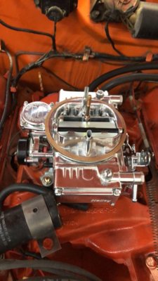

  16. john visconti
    Messages:
    122
    Likes Received:
    Joined:
    May 4, 2019
    Yes true I forgot about that.
    What CFM Holley or carb number?
    I just got a 600 CFM with electric choke for free it’s a polished carburetor I put it on for now
    Rich B likes this.

  18. Rich B
    Rich B Well-Known Member
    Messages:
    52
    Likes Received:
    Joined:
    Jun 23, 2019
    Location:
    Minot, ME
    Gorgeous, I’d keep that if it’s working good. Can’t recall CFM but close to Carter, learned not to overdo on bores. My ‘Lil Red Truck had a good Carter with phenolic body to keep fuel cool, had vapor lock back through the 60’s, ‘70’s with hot engines sometimes.
  19. john visconti
    Messages:
    122
    Likes Received:
    Joined:
    May 4, 2019
    Yeah I priced it it was about 300 and change I just had a Mustang that I’ve acquired and it had a lot of extra parts with it so I got this for free.
    My old one had no choke
    Rich B likes this.
