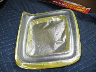

Here is the tail light's with the argent agent on them one with the tape off and waiting for the other one to dry before peeling the tape off. Did get some pin stripe plastic tape to do the line off. It worked grate. 1/4 inch like Bob stated. Used 3/4 yellow to tape off what I did not want to spray. Waited about 30 minutes before peeling tape. So here is one finished and one waiting to pull the tape. IMG_0102 (1).JPG IMG_0101 (1).JPG
