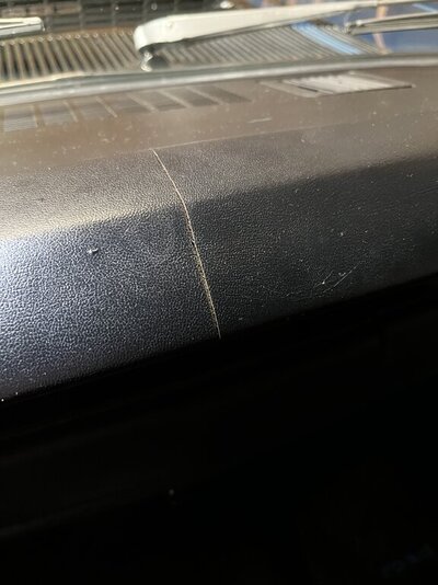

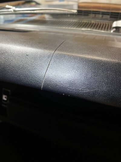

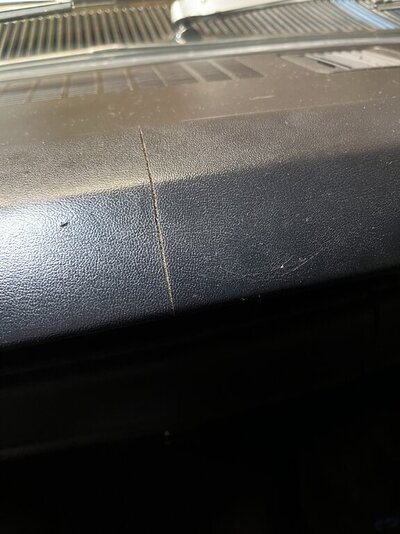

Drove the car out of the shop yesterday and got home and saw this! Repair or Replace?
Is it a tuff replace?
Thanks!

hard to find not cracked if you find one it can be big money or you can use a cap they sell i did mine with a cap.
3,974
690
You can have recovered by Just Dashes but get ready to bend over, but you get what you pay for. The repos are not that bad just a little bit short creating a slightly larger gap on the sides where the a pillar covers meet. Repairing with vinyl patch will fill the crack put you will always be able to see it as the grain can never be blended well. That is pretty much your options. If it were me, I would go with the reproduction.
