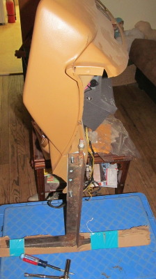

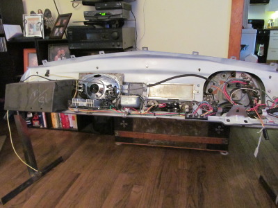

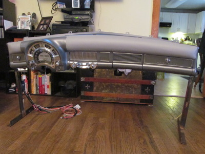

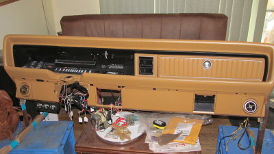

Make some stands too. I made some out of old bed frame. Here's a couple pics of them holding my 300 dash and my 53 Windsor dash.

If the windshield is out, the dash comes out fairly easy.
Thank for the tip Big John! That 53 Windsor Dash on the the stand is like a work of art too
Do you have any pics of the 300 dash from the front when it was on the stand?
And just for laughs, the back of the Windsor dash. I painted that white so you can see it better from underneath.
