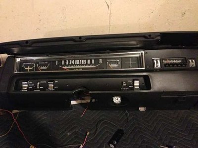

Ok thanks ill pick up some tomorrow. Chrome bezel should be here tomorrow so I should be ready to re assemble! Will keep posted

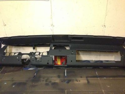

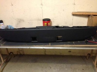

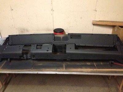

Fresh paint on the frame [attachment=2:2rdoj4g7]ImageUploadedByTapatalk1357255495.651596.jpg[/attachment:2rdoj4g7][attachment=1:2rdoj4g7]ImageUploadedByTapatalk1357255526.601623.jpg[/attachment:2rdoj4g7][attachment=0:2rdoj4g7]ImageUploadedByTapatalk1357255561.518420.jpg[/attachment:2rdoj4g7]

I didn't use the suede paint. I took the dash frame which had all the suede finish intact, just was faded all over and I have it a light hit with scotch bright. Enough to promote adhesion but not enough to remove the finish. I then used laquer thinner and cleaned and clened until the rag finally swiped clean (took forever). I then applied many light coats of rustoleum automotive rattle can (fan tip for better coverage). Applied just enough to cover dash and not bury suede finish. Bezel will arrive today so I should be able to put everything back together.

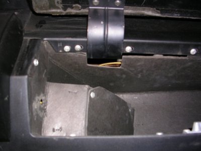

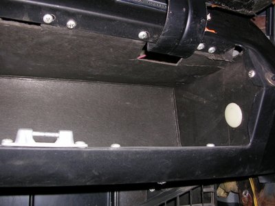

Can I please have pictures of the glove box liner installed with correct screws? And if the glove box door installs under the insert? Also is there any protective hood around the glove box light? It just sits next to the hole in the liner?
Not done putting everything back together yet. The Temp switch wire has broken and we are going to fix that and also the dash speaker has to be reinstalled with a working speaker. Did most RR come with only the dash speaker?
Yes everything was an option, rear speaker or three speaker dash.

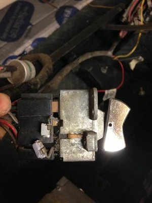

I have a few snipped wires and soldered wires that we are sorting out, dimmer spring is a little kinked. Wiper motor switch has a break. Can anyone still send me pic of globe box, glove box light and door?

[attachment=0:5t3a2fnw]ImageUploadedByTapatalk1357404922.397738.jpg[/attachment:5t3a2fnw]
22,302
2,552
Hope this helps
