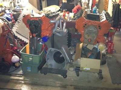

So before I even finished building the 383 I have decided to just go with a 440. Parts are cheaper and I'll reach my goal easier with the extra cubes... besides who doesn't want to say they have a 440 under the hood? :drive:
ignore the messy garage... 440's on the right.
anyways the pistons are the opposite of domes (can't think of the word) so I'd like to replace them (rest of the engine looks good it hasn't had many miles since being rebuilt and the cylinder walls look clean no damage so I'm looking for standard bore pistons and wondering what you guys suggest. I was looking at the speed pro TRW forged pistons, but I just don't know... http://www.ebay.com/itm/Speed-Pro-TRW-D ... 953wt_1037

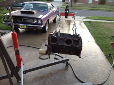

Sure is, parts are cheaper lol. Everyone told me the 440 was the way to make lots of power. Probably just going to change the pistons (you can see in the first pic), clean up these 906 heads, run a larger cam, rpm performer intake and see what she runs. Then work on other things until I want to go faster.
