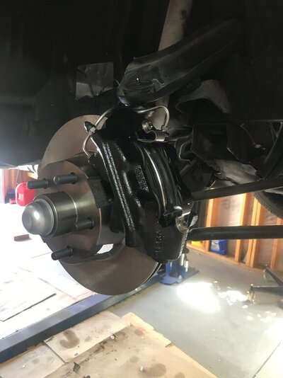

Finally got it done. Bolted right on, no spindle change needed. There was an issue with the caliper mounting plate. I had to drill the two lower 5/8 holes where the bracket mounts to the spindle and lower ball joint. Overall easy install.

I think it was you that asked me to let you know how the installation went. It wasn't bad. I had to drill the 5/8 holes at the bottom of the caliper brackets but all in all it was what they said and it bolted right on. The tech line answered all my questions too.

I got it all done and driving. Man, that makes a big difference. I really like the disc brakes. I recommend doing this on any classic. Well worth the cost and effort.
