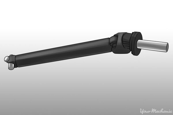

How is the right way to measure my Drive Shaft. I may need to replace mine if I install a new DANA 60

Car must be on its suspension. Measure from middle of rear u joint to back of transmission. Subtract about An inch to allow for suspension travel

While I don't disagree with Quickie's approach, I'd suggest that you confer with the shop that is actually making the driveshaft. They may want to have a different set of measurements to ensure a correct fit as it will be their name and reputation that is at stake. Such as these guys, who have made several driveshafts for me over the years.
