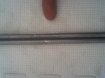

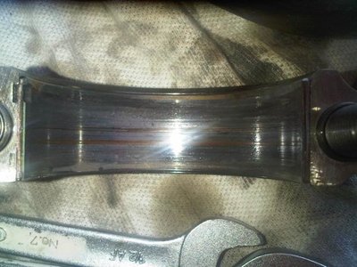

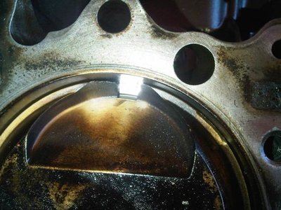

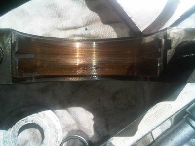

According the guy the engine was only 600 miles old.
Thats why no warranty.
After engine was taken apart Stage V could tell me , based on the serial number the heads were sold to RBRE in 1996.
The oil pick-up tube was made custom ?? to clear the 4.5" stroke.
Heads had previous damage and the cilinders and combustion chambers that had piston damage had no damage to the valves.
So clearly not happend during my 900 miles I could use the engine.
The damage is so expensive to repair that a new 572 rotating set is cheaper.
Clearly a time where I payed some learning money.
But the heads and block are ok.
Have ordered the 572 set from FHO and the FastMan EFI cam from compcam has been ordered.

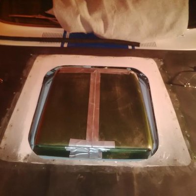

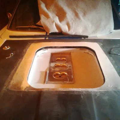

Work has been on (s)low speed.

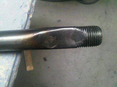

Intended to get EFI done on dyno but put bird in guiderail 2 weeks prior.
Have been sick of it for some weeks.
Have removed 8,75 and awaiting S60 end January.
Steering box removed and fitting new (Borgeson).
Also been fiddling wtih the hood.
I think you get the idea i'm shooting for.
