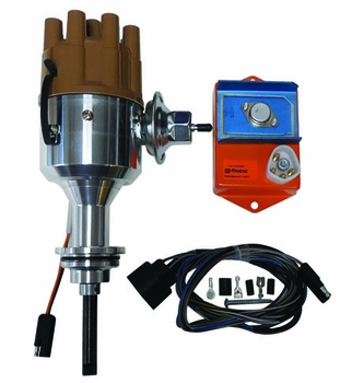

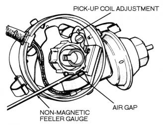

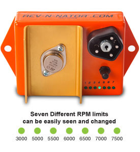

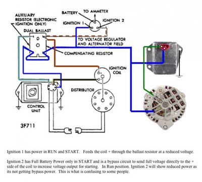

I'd highly suggest to do the any of the magnetic pick up ignitions, many to choose from, Mopar Performance CEI Conversion, Mancini Racing sells a few different types... They offer less tuning hassles, better cold starts, hotter spark/longer spark dwell than points, don't wear out like points either... get a Orange Performance ECU... Good luck
Chrysler Electronic Ignition Wire Diagram 4 pin Ballast & Electronic Volt. Regulator.jpg

MRE Mancini Racing firecore electronic distributor conversion kits 361-383-400 MRE90427 $239.jpg
MRE Chrysler electronic distributor conversion kits w-orange box 361-383-400 MRE-6993 $199.95.jpg
