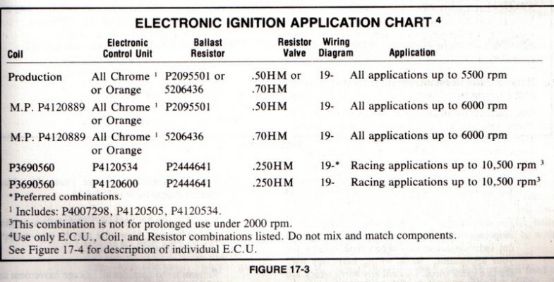

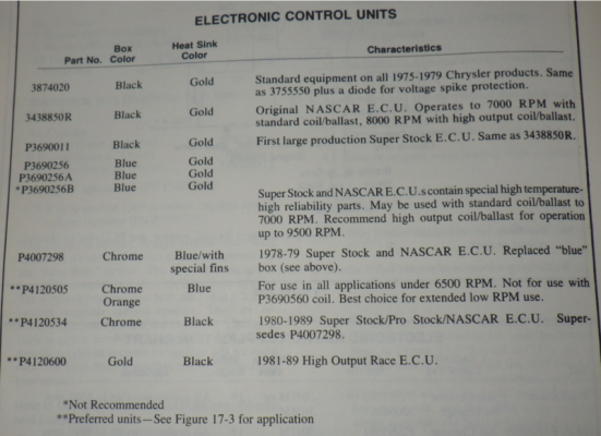

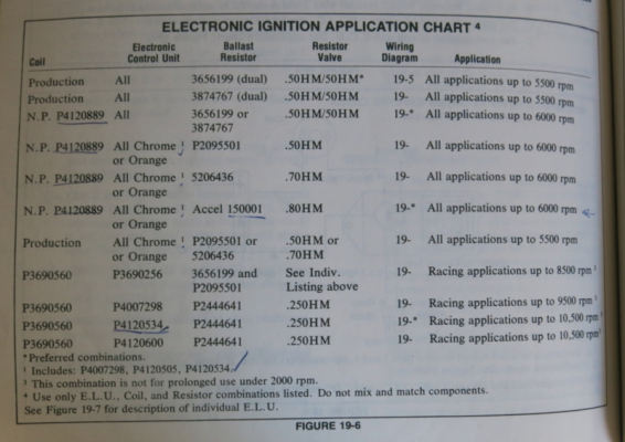

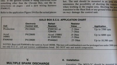

Look at post 13 I posted some of the box info up. Remember that is just Mopar made boxes not aftermarket and new authorized boxes.
