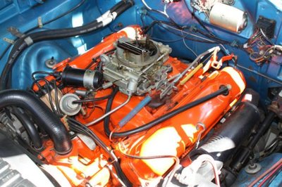

Looks like 42 equals a Holley according to my book...see if Bob agrees...Here is a survivor pic....
