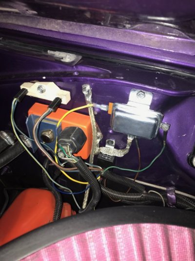

Well it did it again. Died right in my back yard this time. Hooked up an extra plug wire with a plug and no spark. Only does it when it is hot. This time I ground off the orange coating on one side of the box and used a braided ground strap. Drove it for about 30 min and no problem. Stopped and let it cool then started it up a few times and no problem so far. Last time all I used was some star washers that dug into the orange box. We will see what the dedicated ground strap does.
I'm no expert, but the braided grounding strap seems like a lot

Yes I also put a braded ground strap to my CEU box plus one from the motor to a bolt under my batterie box. Cleaned off the paint on the bolt on the ECU box. Think that is a good thing to do for a good ground. When restoring we paint every thing so well that a ground is hard to achieve sometimes.

Will you guys please send me pictures of your orange box wiring. You see the relay to the right of the orange box? I'd like to see what the wiring looks like without it. Thanks.
