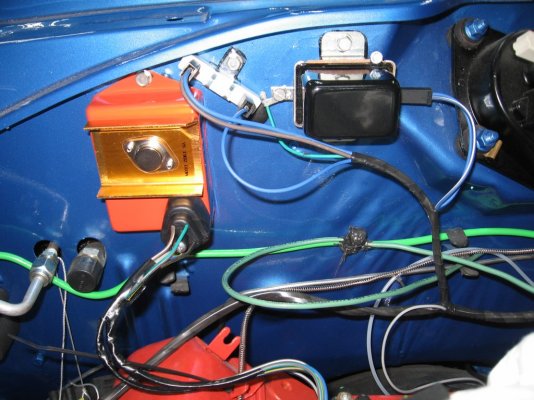

Is this the pic you are looking for Terry?
7,846
3,425
I have the voltage regulator still. IMG_0102 (3).JPGGot a new distributor and every thing from summit racing. For around a 145.00. Figured the old one was old and needed to put new in to head off problem's. Had to cut in for a few splices and direction's explained it all.
7,846
3,425
Sorry the picture dose not show the ground strap on the ECU box but have one on it now. That Green wire #6 is a ground wire running through out the car from front to back just for a back up it is grounded to the batterie.

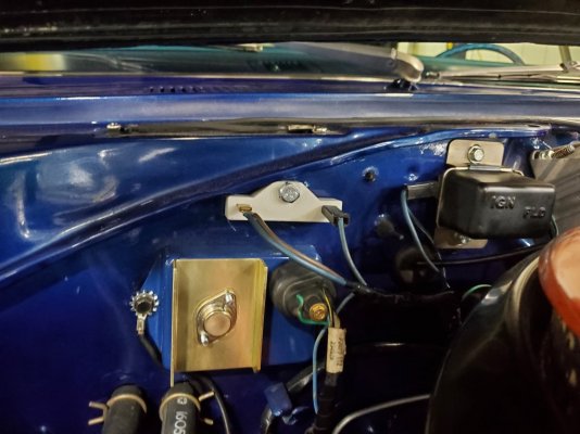

OK, this is making me crazy. The engine runs great and then it's like you just turned off the key. If you let it sit for about 10 minutes it fires back up and runs fine till it decides to die again. It has the early electronic ignition with the orange box. I have checked the wiring and changed the coil, same problem. I have also been experimenting with different carburetors, not for the shutting off reason but for performance reasons and it does it with all 3 carbs. Suggestions please.
yes it hole in gas line getting air in the line gas line at the gas tank
