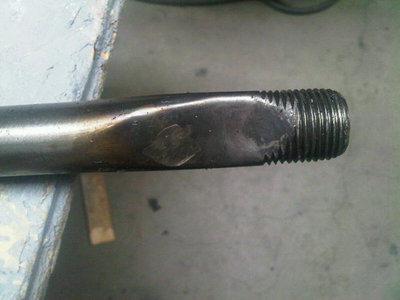

Was at local speedshop Thursday and Friday to solve crankseal leakage.
Found some interresting thing inside oilpan.
The 4.500 stroke crank normally does not permit an internal pick up tube.
The guy I bought the engine from said it had a special made pick up tube for internal use.
Found the tube made fit with hammer and grinder.
Also was still hitting the rods bigend and had almost broke trough the tubes wall.
If this would have happened the vacuum would have gone and the oilpump would no longer be able to pull oil up and this would have been the end of the 572Hemi.
This is now solved for the moment.
Will convert to Milodon external pick up and pumplid soon.

Good thing you caught it, losing that engine would be awful. How did you think to pull the oil pan?

Zupanj: Pulled the pan due to leaking crankseal.
[attachment=0:2gzuhw2g]Oilpump tube.jpg[/attachment:2gzuhw2g]

Kind of makes me wander what other short cuts were taken :huh:
dutchrunner
Mar 21, 2010
458
The Netherlands
Re: F&B 6BBL XFI2.0 572Hemi(close shave)
Me2 Hemi.
Will drive this season very carefully.
Engine will be ejected this winter and torn apart 100%.
Like to spend 2K for teardown instead of 10K in broken parts , or worse.

Think I'll take the Milodon oilpump and lid with the external single pick up and static inside 7qt pan.
Will not see >6000rpm.
