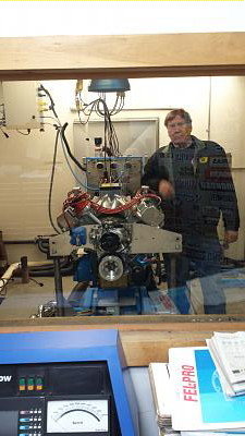

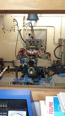

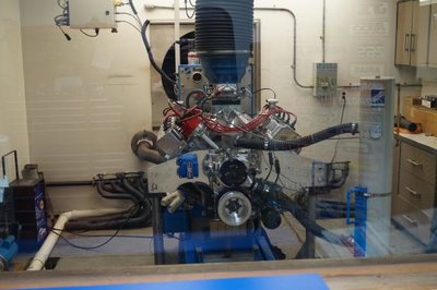

Finally dropping off the Hemi saturday for engine dyno
george68hemirr
Jan 23, 2009
12,645
71
hudson valley ny
Did it not go well....you look miserable in the photo :D hope that thing goes as good as it looks :thumbsup:
My brother snapped the photo before i smiled and gave the thumbs up.....it went well.....like i said we just dropped it off.cause he didnt have time to run it today
301
who's the ugly bastard standing by the Hemi?:bart:

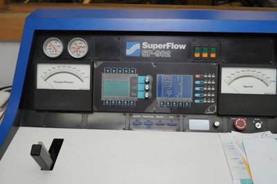

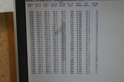

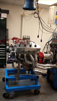

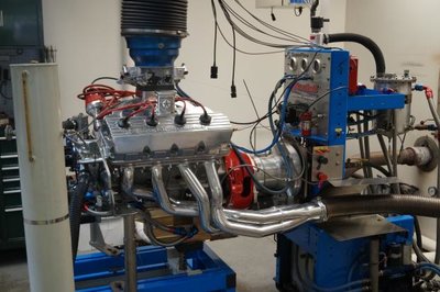

OK....DYNO TODAY
first pull was at 6500 rpms....855 HORSEPOWER
second pull at 6800 rpms......877 hp at 32 degrees timing
3rd pull at 7000rpms.....887 hp at 34 degrees timing with 753 torque at 5400 rpms
i am very happy with that....he ran it with 109 octane racing fuel
the engine builder set the valve lash @.006 intake &.008 exhaust......hemi heated up we pulled the valve covers and lash grew ....intake was .028 & exhaust .032.....what i needed was .022 intake &.024 exhaust.....so we set them plus float levels on dominator and went for some pulls.........ran into some oil leaks....was not too happy.....rear main....plate behind oil filter which bolts to side of oil pump and dip stick.....
.i tried to download video whish was 1st pull but was 227 mbs....too big but was able to download on facebook.....here it is....
