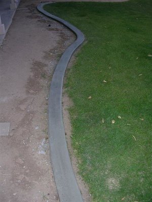

'bout tlme you get sumth'n green out there!

Patients grasshoppers. After the Saudi oil and land Barron leaves its coming back across the yard where I can work on it again :toetap: Until then fell free to beat me up :lol:
