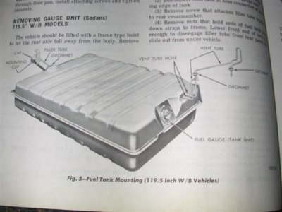

On the back of my tank, there's the supply line and electric post on tank gauge sending unit, it can and has been replaced. Then over about six inches to the top are two vent tubes. Hooked up one goes up through the body and loops back down.

3748024-DSCN273928Custom29.jpg One vent goes up into the trunk and back down onto the outside the other goes straight up into a little metal J shape. Vapor separators were used on Hemi's and 440's and used a different fuel pickup at the tank and separator at the engine with a return line to the tank.

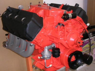

22,277
2,524
It's the small black canister mounted with the fuel pump. You can buy fuel filters that do the same thing.roadrunner restoration 680.jpg
