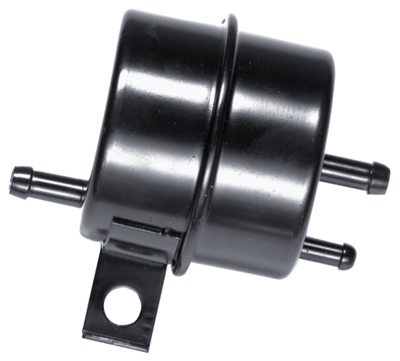

x868.png Yes the tank is vented. The 3/8 pickup with the return was originally used on Hemi and 440 6bbl cars with vapor separator at the fuel pump, the 5/16 pickup was used on all other engines
