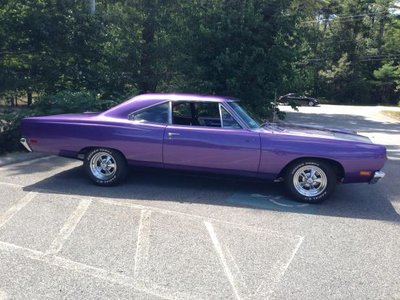

Mine has 4:11 I'm changing to 3:55 for better drivability. Hope this helps. image.jpgimage.jpg
