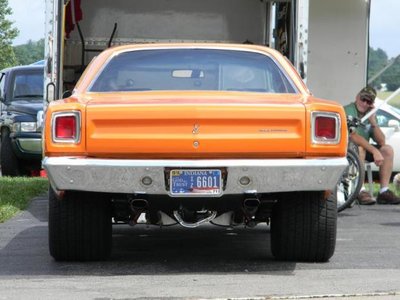

The 69 rr has one of the nicest rear ends of any car out there . Simple , clean and sexy ,even in primer !
