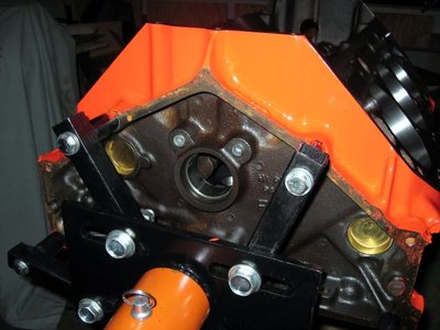

I can feel your pain. Just to help sympathize with you and maybe give you a chuckle. I built an engine for a friend and it leaked from the rear pan area. I pulled the pan 3 times and changed the rear main seal every time. I even changed out the the pan thinking that was the problem. I finally pulled the engine to check the bearings and found that the cam plug was leaking down the back of the engine and hitting the top of the seal and running around down onto the pan rail. I had built many motors at that time and I would have bet my life it was the rear main that was leaking but until I removed the flywheel I couldn't see the cam plug! A $2 item caused me so much grief!! These things make you grow as a Mopar owner.

So you pulled the trans, bellhousing, clutch, and flywheel? That is the only way you could possibly see the cam plug.

Just so our communication is clear. Here is a pic of a block with the cam plug removed. Its the 2 inch hole between and just below the two pipe plugs.
